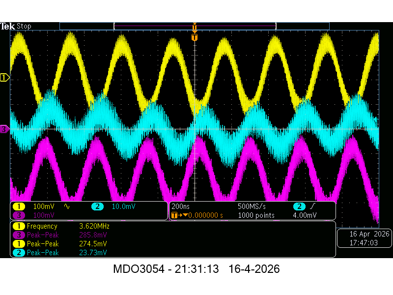

Anyway, i can reproduce your values in the sim, but when i try it on my real circuit, things are very different.
Firstly, the 10mV (20mVpp) input from the FG is so low, my scope has problems showing it, see the blue trace (23.7mVpp) in the screenshot below.
But also this low input voltage seems problematic for the rest of the circuit as the voltage across the 100pF capacitor is still very low (274mVpp, see yellow trace).
When using my differential probe across the coil L1, it not only influences the resonance frequency (3620kHz), but it also shows a low value as 285mVpp, see purple trace:
In this situation with 20V input, there is 1.12A running through my 10.4 Ohm emitter resistor which get hot quick.
I have to increase the FG input to at least 150mVpp to get some readable signals, but still the Q will be around the familiar level of 11:
Further increase of the input (500mVpp) lowers again the Q, see here:
I indeed think the 2N3055 has problems with the used frequency, and also the probes seem to have again an impact on the Q as well.

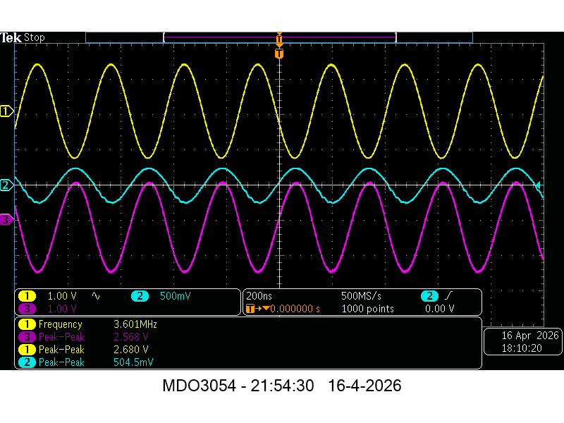

An initial test with the 2SC5200 looks better, but i just soldered the 2SC5200 in place of the 2N3055 without changing something else.
I have 214mVpp in from the FG and 5.5Vpp out across the 100pF cap pointing to a Q of 25 (differential probe across L1 removed).
I will use a 220K trimmer for R2 and look for a sweet spot later on today.
i installed a 220K trimmer pot as R2 (2N2222 base to ground) and played around with the input voltage, input signal from FG and trimmer setting while keeping peak resonance.
It boils down to a max. reachable Q of 25.9.
The input voltage is 20V, the current through the 10.4 Ohm emitter resistor is 1.38A, the trimmer pot is set to 213KOhm and the input signal from the FG is 280mVpp (blue trace).
This results in a resonance voltage across the 100pF capacitor of 7.2V (yellow trace), with a slightly distorted input signal, see screenshot:

Because the AC voltage is surely less across the 10 Ohm than the AC input from the generator, this means the Q is higher than 25.9 (the 7.2V then is divided by a less than 280 mV value).
I made a new screenshot, with the FG output signal (now 310mVpp after cold startup), in white, and in blue the AC voltage across the 10.4 Ohm emitter resistor, while in yellow we still have the voltage in resonance across the 100pF capacitor:
I used another 100pF which measures the same as the old one.
When using the white trace (FG) as input, the Q = 26.8,  when i use the blue trace (across Re), the Q = 9.9

I had one T200-2 with 40 turns of 1mm diameter magnet wire lying around, so i removed some turns and at 37 turns i got an inductance of 16.8uH, so i used that.
This was the result without any other changes since yesterday, so still at 20V with 1A through the 10.4 Ohm emitter resistor:
Yellow is the output across the 100pF capacitor
Blue is the input from the FG (set at 280mVpp)
White is the AC voltage across the 10.4 Ohm emitter resistor.
After reducing the input voltage to 12V with 500mA through the 10.4 Ohm emitter resistor i got this result:
So in both cases also with this new toroid, the AC voltage across the 10.4 emitter resistor is higher than the FG input AC voltage.
Perhaps the darlington setup is not appropriate for this situation?
