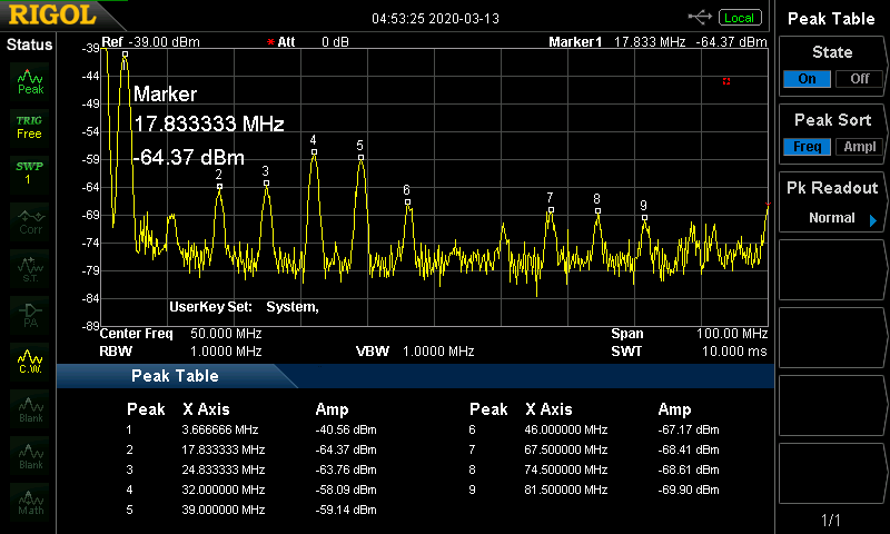

Now the question is, what causes the gain?  In looking at the last pix of the spectrum analysis, it is my opinion that the gain comes from the harmonic content in the output loads that is being generated or accumulated in the device itself.  Look at the shape of the output in CH3(pnk).  It obviously contains many harmonics as is evidenced in the spectrum analysis.  Note that all the harmonics are odd (start with the fundamental being 3.545MHz).  In testing a similar device with a different coil arrangement, the gain was lower along with lower harmonic levels.
So, if this is true that additional power is coming from the generated harmonics, then the challenge would be to arrive at the optimum parameters that are creating this effect.  At this point, I do not know how these harmonics are being created!

There is no ferromagnetic core material used, all air cored.  The pancaked coils are clamped together tightly with flat plexiglass pieces and a plastic bolt in the middle.  I'm considering that the source of the harmonics is in the fact that the open ended primary is basically an open ended transmission line with reflections back to the driven end.  Why these harmonics are all odd is a question now that remains unanswered.
