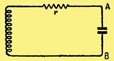

I came across the super-regenerative receiver and found it very interesting, especially when considering how to build large voltages in a circuit. It reminded me somewhat of Tesla's magnifying transmitter & receiver. Could this be combined with an avalanching diode as the RF source signal?

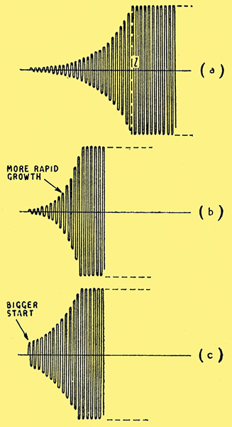

If a tenth of a penny had been invested at 5% per annum compound interest in the year 1 AD it would today have grown to £100,000,000,000,000,000,000,000,000,000,000,000,000 or roughly a lump of gold as big as the whole world for every 10 seconds through all those years. As the super-regen amplifies on the same principle, a phenomenal gain is only to be expected. Its voltage amplification is limited at one end by the size of the smallest possible voltage (i.e., noise) and at the other by the power-handling capability of the valve, and is of the order of a million. That is assuming the oscillations have time to build up to the limit. The lowest QF that does not cut into speech frequencies is, say, 10 kHz, so half a cycle lasts 50 μS. judging from the examples already worked out, it looks as if we ought to allow for several hundred RF cycles in this time; say 500. That puts the lowest RF for most effective performance at about 10 MHz (30 metres wavelength). The lower the RF, the stronger should be the quench oscillation, in order to build up within the limited number of RF cycles.
On the other hand, if the RF is very high and/or the quench is very powerful, it is better to increase the QF, in order to get more build-ups into a given time. The QF giving the most amplification is that which just allows time for full build-up and die away in each of its cycles.

The idea was very interesting in the old days, since by looping part of the output back to the input, the gain of a single tube or transistor amplifier could be increased because the signal passed through several times, at the same time the selectivity increased because the feedback favored the tuning frequency.
Of course the main problem was the triggering of autoscillations, and when radio hobbyists in the 30/40's had their antennas close together, they would interfere with each other.
The reaction is not limited to the electronics, it also puts energy back into the antenna. This is a positive effect for reception, and not well known. The energy re-injected into the antenna opposes the received ambient field. The ambient field around the antenna decreases, but since the energy is conserved, this field energy is found in the input circuit of the receiver. So it is as if the antenna is acting on a larger volume of space around it, recovering more energy.
