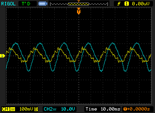

Sorry I misread your post, Here is a CSV file with a math trace on the screen AxB. I had to change the file extension/type to bmp as the site won't allow the uploading of CSV files, you should be able to just change it back.

Maybe if the circuit is floating or grounded in a certain way and somehow synced to the house power phase, it might be possible to light some LED's by utilizing some stray mains power.
OK, so I've played around with your CSV file in the LibreOffice Calc spreadsheet. There is something weird going on for sure. Did you change some scales or something, or maybe the CSV file isn't reflecting the actual channel voltage scalings properly? Do you have a screenshot of the scope's display of this same data? The screenshot up above appears to have more data on it than what I got in the CSV file, did you change the timebase?
Anyway, here's the process. First I just doubleclicked on the CSV file (after changing the extension back to CSV). It automagically opened the LibreOffice Calc spreadsheet import box. Then I imported it, with the "detect special numbers" box checked and the "delimiter" selected as '  .  (Otherwise the CSV's expo notation is imported as text rather than numbers.) Then I widened some columns, selected 5 places after decimal for the number format.  The file only contained columns for the time and the two channels, no math. So I added a Math column and had it compute the multiplication of the two channels values. Then I made a plot of the data range, using the "x-y" style plot format, and played around with the axes and etc. to get it to display properly. The spreadsheet math functions did not include RMS, so I had to make up a function to compute the RMS values of the two channels data, and this required having the Squared values, so I added two more columns and had the spreadsheet compute the squared values, then I computed =SQRT(AVERAGE(columnvalues)) to get the root-mean-square values for the CH1 and CH2 data. Getting the average Math was easy using =AVERAGE(columnvalues).
But the values for the CH1 and CH2 voltage values that went in in the first place don't seem right when compared to the "Stray Voltage" screenshot you posted up above. So I don't know really what's going on. I'll have to try to set up something on my scope and look at its CSV values to see if I can figure out if there is any discrepancy in scaling, or what.
Posts: 564
Umm yes and no to those questions respectively. I may have changed the scales as I produced the waveform in a haphazard way, and no the scope shot above  won't match the CSV data because I used a slightly different method, I touched one probe tip to the bench top (aluminium) and the other probe tip to my right thumb. Which produced a more sinusoidal yellow trace, then I think I had to adjust some vertical scaling to fit the wave forms on the screen but keep them as big as possible, and I did not capture a scope shot of that. My head was not completely in the game. I'll look at the file you produced now, I have Apache open office.
P.S. WOW, TK that is frickin awesome, the math trace looks almost exactly like it did on the screen. It is quite possible the scope does produce an accurate CSV file.
I just woke up so I'll go get a circuit from the mountain in a few hours and try to get it set up early tonight, I'll have to get some kind of table down here to work on. I just gotta hope my cars tow ball is high enough to tow a big trailer meant for a 4x4. Then hope they will lend it to me. Or I could just make up a tank and use the function generator to excite it so I can get a sensible pair of wave forms at a lower frequency from a small setup to test the validity of the CSV data, and to learn to do it myself. I don't have a non inductive resister here but I do have one or three spare ones loose up the mountain.
As those were two voltage measurements out of phase the Watts figure is only demonstrative. But it looks very good. I am suitably impressed.  O0
First time I've used the scope in almost a year, time fly's.
Thanks, you've kicked started me again, I feel the need to learn how to do that myself quite acutely.
