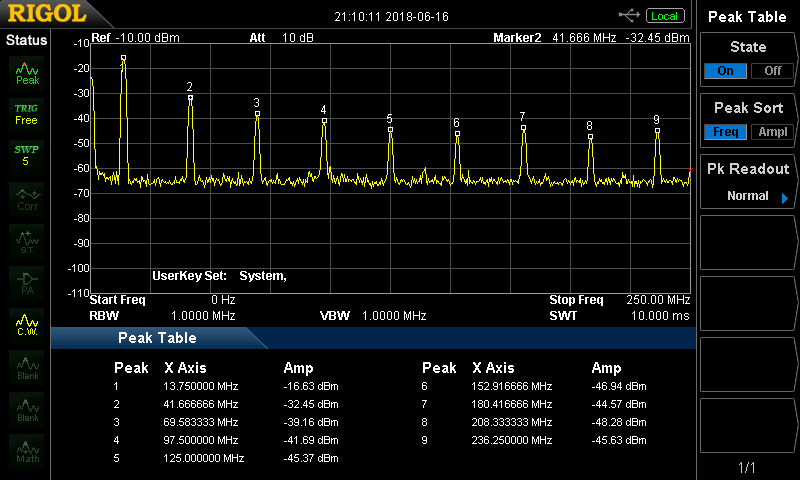

Picture is a zoomed in spectrum from the spectrum analyzer, left peak is the operating frequency peak 14.8Mhz,
to the right we see harmonics and noise up till 595Mhz.

I ran a another test of the same setup minus the SA sniffer but with a non-inductive 100 ohm resistor is series with the input lead.  I then took input power measurements and compared the probe measurement to the current produced by the differential voltage across the 100 ohm resistor and used the results to produce the mean power.  CH1(yel) is the output from the SG and input to the 100 ohm resistor, CH2(blu) is the output of the 100 ohm resistor, CH4(grn) is the probe current, and Math(red) is the power in mean watts.
The results are shown in the scope pix below.  The first is the power input based on the current as measured with the current probe and is -6mw.  Keep in mind the resistor is in place for both tests.
The second pix is with the 100 ohm current measurement and shows to be 48.8mw which I believe to be the most accurate measurement.  The proof is in the fact that the p-p output voltage of the resistor shown on CH2 is less than the input voltage shown on CH1.  If we were really pumping energy back into the power supply, the output voltage would be higher than the input.

Here is another test using a 1 ohm csr with the same probe connections as before.  The results certainly came out different.
The first shot is using the current probe for the current measurement and the second is using the csr.  Both are still in the negative input power region.  The csr measurement is shown in mvv but is actually mw.
I've also included a pix of the harmonics of the setup at resonance using my Rigol SA with a sniffer laying close to the inductor.  These odd harmonics are not present when the LED are not conducting.  I also had a 10cm length of wire connected to the junction of the 1N4148s which adds capacitance and lowers the resonance frequency.  This wire was not attached for the scope pix.
I'm curious as to what your results will show.

Added my SA peak table

OK, here is an up-to-date test after a considerable equipment warm up time followed by a scope re-calibrate.  The gain differential between CH1 and CH2 was several mv worst case.
The first scope pix is measured with the same csr setup as before and with the LED array uncovered on the bench so it is being hit by ambient room light.  BTW, on my current setup, there is no light output coming from the array during this test so I've included a check for Tinman's concern of the LED array acting as light generator and being the source of the negative energy which is a good point.
The second pix shows the measurements taken with a complete cover over the array and with the lights over the bench turned off.  There is a slight difference but the majority of negative input still remains.  Also the level of negative energy input seems to agree reasonably well with the previous averaged input after correction of the channel gains.
Itsu, I agree that we are really pushing the limits of these scopes and I would like to add that I have increased the sensitivity of channel CH1 and Ch2 to get the maximum accuracy.  I don't remember if the TDS series will allow this or not.
Edit: I have to amend my comment about there being no output for the array when it produces negative energy.  The condition ranges from no light to a small amount of light output during the the measurement of negative input power.
had very little time again today, will do some further tests tomorrow.
I did use my black box with solar cell inside calibrated to the used led strip on DC input voltage.
It shows a very poor input / output relationship, like 12mW output at 200mW input.
Video here:  https://www.youtube.com/watch?v=fVcKd1tApDM
