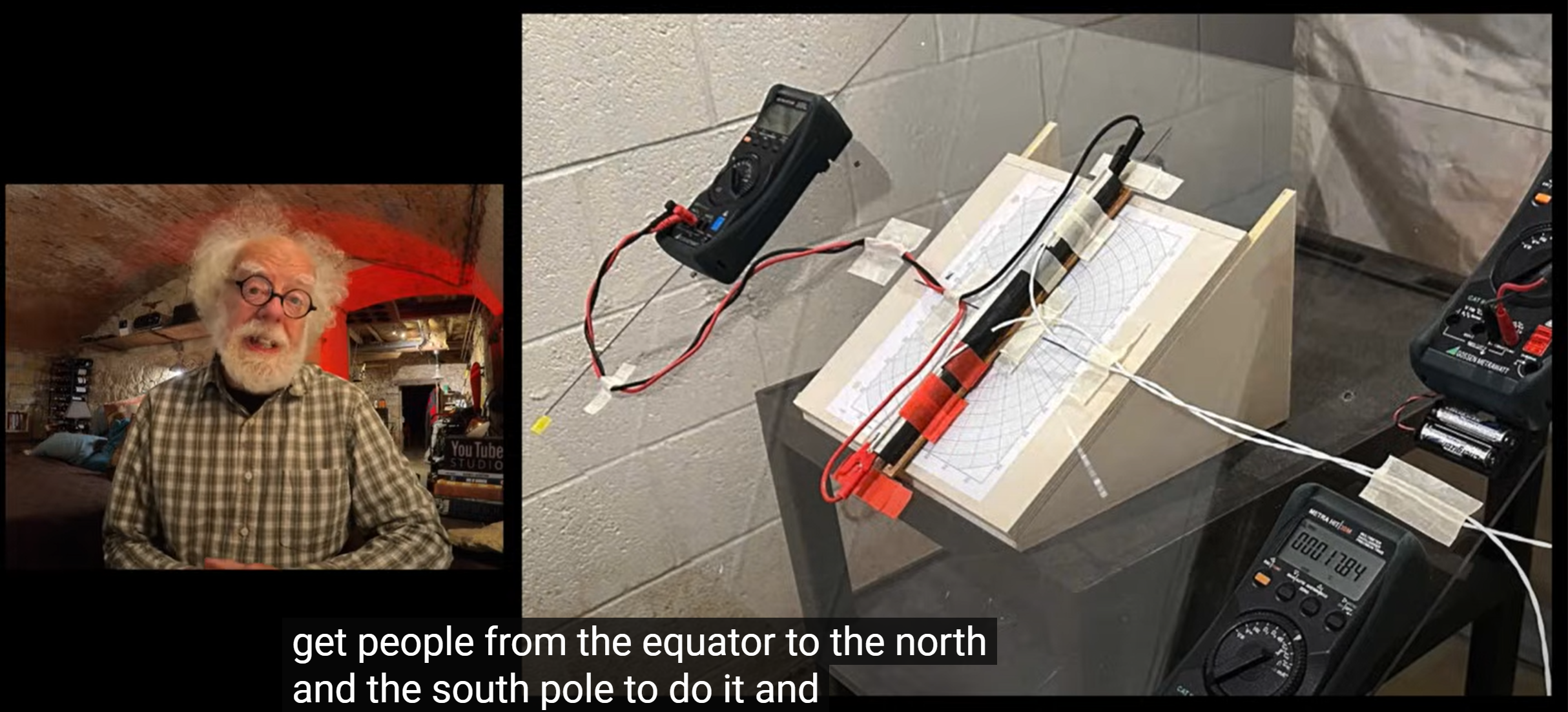

In any case, with a 30 cm MnZn ferrite tube, they claim to produce a permanent voltage in the 15 µV range, eliminating possible temperature-related artifacts, and opening the door to possible scalability (otherwise, of course, the interest would remain purely theoretical).

In any case, with a 30 cm MnZn ferrite tube, they claim to produce a permanent voltage in the 15 µV range, eliminating possible temperature-related artifacts, ...
I will believe it if that voltage varies sinusoidally as a function of the tube's angle.
It would make a novel compass.

https://www.youtube.com/watch?v=jzHEmphBeFM
According to this video, the voltage DOES vary as a function of the cylinder's orientation angle. I mentioned this  here.
  • Also, a full rod/cyliner does NOT work but a hollow one does.
  • Furthermore, the choice of the material matters (the ones with lower magnetic Reynold's coefficients are better, e.g.: MnZn)
  • A larger diameter hollow cylinder is supposed to generate a higher voltage.
  • The generated voltage is supposed to be higher at lower geographical latitudes.
  • Last but not least, thermoelectric and photoelectric effects have been ruled out.

Here is a FEMM run of a Ferrite tube in a uniform magnetic field.  Shown there are two conductors crossing that field, one inside the tube and one outside the tube.  I show the B field magnitudes given by FEMM for the two positions.  The field inside the tube is virtually zero.  Now if the tube and the conductors move together in the x direction will there be a difference in the v X B electric field seen by the conductors?  If the zero B field at the inner conductor results in zero v X B electric field on that inner conductor then the answer is a resounding yes.  So we can construct a rectangular closed loop that extracts energy from that movement.  Admittedly FEMM is only a 2D program so it simulates something that is infinitely long in the z dimension.  But we know intuitively that a long tube (length greater than diameter) will exhibit its magnetic screening properties around the centre point so we can still construct a rectangular loop that doesn't extend near the ends.  Worth trying the experiment.
Anyone up for trying this experiment?  The voltmeter has to register 10's of microvolts DC so maybe not just a simple meter.  A more complex experiment uses multiple turns in the loop (say 100 then you are in the millivolts range).  I am surprised this has not been done before, but then maybe it has and I am ignorant of it.
