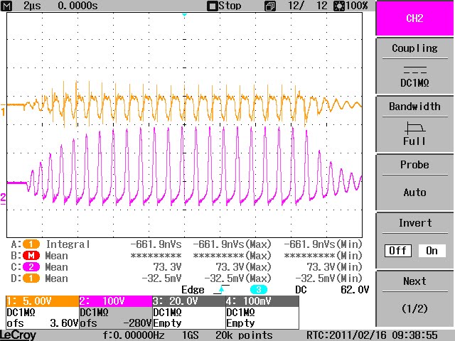

I think that we got a big clue from Rosemary about what's going on in her circuit and the 1.2 MHz oscillations:
Just out of interest that beautiful waveform entirely disappears at below 36 volts from the supply
So her supply voltage is quite high, it looks like it is 72 volts (6 x 12 volts).   She only gets the 1.2 MHz oscillation above 36 volts.  So she has to push the supply voltage way way up, and that's increasing the gain in her MOSFET-based circuit.  The increased gain eventually becomes high enough to initiate the output-to-input feedback loop to start the oscillations.  It's the same thing like getting feedback between speakers and a microphone if the speaker volume is loud enough.
From looking at the above graphic it appears that we are seeing the types of voltage spikes associated with interconnect wire inductance that we have been discussing recently.  When the current is flowing you can see that the shunt resistor voltage is bumped up a bit and the battery voltage dips low.  Then when the shunt current makes a quite sudden drop down, that's when we see the battery voltage spike up.  That would be consistent with a length of wire from the battery positive to the device power input terminal discharging its stored inductive energy.  If the probe monitoring the battery voltage was placed on the device power input terminal and not on the battery terminal you would see these positive spikes.
The key point here is that the big positive spike in battery voltage is a fake-out.  It is not representative of current flowing back into the battery and recharging it.  It actually represents current sill flowing out of the battery. The big positive spikes are due to the interconnect wire's inductance discharging and attempting to push current into the device itself when the MOSFET is switched off and resisting any attempt for current to flow.  That resistance to current flow results in the wire inductance raising the potential into a high spike.  It's just the "Inductive Laws" in action.
This is all just a preliminary analysis and the information available is incomplete so I cannot be sure about my comments.
MileHigh

Perhaps the link for the scope capture didn't work when you looked at my last posting.  A reload might do the trick.  Amber for the current and pink for the "battery" voltage.
MileHigh

MileHigh
All I see is wild resonant oscillation during the OFF time...what do you see?  ???
.99
.99
What I think I see is that during the OFF time the MOSFET is still switching fully (or nearly) ON and OFF.  It looks like the OFF to ON transition (current waveform)  is sharp such that you see a single-pixel-wide glitch at that time.  I am assuming that there is a fast low to high transition at the MOSFET gate input that creates the glitch.  That transition lines up with the shorting out of the positive voltage spike on the "battery" voltage.  Note also that  the "battery" voltage spikes start to increase when the ON to OFF transition is at it's fastest.  If it's due to inductance in the wire from the battery positive terminal it means that the big positive spikes in the battery voltage are not actually there across the battery terminals..
MileHigh
Posts: 3538
It's not as complicated as it may seem...
MileHigh
LOL,
No way, not that slower than molasses IRFPG50!
The Drain is probably oscillating just as badly (and a lot higher in voltage), and those little spikes you see might be the differentiated leading or trailing edges of VD getting through to the Source via the inter-lead capacitance, which is relatively high not only in MOSFETs, but in this model in particular.
Trust me, that baby ain't switchin'.
.99
"Some scientists claim that hydrogen, because it is so plentiful, is the basic building block of the universe. I dispute that. I say there is more stupidity than hydrogen, and that is the basic building block of the universe." Frank Zappa
Posts: 1888
I am more likely to trust you on this one than I trust myself!  lol  I didn't even think about the MOSFET switching speed itself.  Just plum forgot.
It looks to me like you could reverse-engineer the oscillation mode if you had the goods.  Funny how you almost always end up dealing with the exceptions instead of the norms with this stuff.  I could never have been a hard-core analog guy.
MileHigh
Posts: 3538
I always enjoy a challenge when it comes to doing something in PSpice.
From Rose's blog, post #58:
Dear Reader
I am not sure that the waveform can be duplicated on a simulator. I'd be interested to see if this is, in fact, possible. Perhaps our Poynty can give this a go. I am delighted, in any event, to see that it's being denied on the basis of a faulty IRFPG50.
Indeed I can, and I have... for the most part. And you may want to pay keen attention to my findings.  ;)
There are 3 differences in the wave forms however, which I will explain below.
osc_repl01.png is greatly representative of the "phenomenon" that Rose is seeing in her wave forms. Specifically, this is in regards to the high amplitude oscillation present on the battery line (and Drain) and shunt measurement point during the period of time in the switch cycle where the MOSFET switch is "OFF".
The difference #1 one will observe here between this and Rose's wave forms, is that the ringing is damped (i.e. falls off in amplitude with time) with my wave forms, while in the wave forms Rose posted, the amplitude appears quite constant.
The cause for the constant amplitude ringing in the wave forms Rose posted, is that the MOSFET VGS and VD are in phase. VGS is being "modulated" by the "noisy" signal on the Source pin, caused by the high impedance path back to the battery. This has the effect of applying negative feedback, and since the MOSFET is a voltage controlled resistance, the D-S resistance is also being modulated in such a fashion to "compress" the Drain voltage. Think of an AGC type control.
osc_repl02.png is a zoomed-in portion of the ringing. Difference #2 is that the phase shift in my wave forms is 90 degrees, while Rose's show 180 degrees. This clearly indicates that there is a second order network in the actual circuit.
I have not included all the parasitic components around the MOSFET, so this may account for the single-order phase shift, vs. second order. With more time, I am fairly confident I could recreate this effect also, however, for the purposes of this post it is not required, as will soon become evident.
The #3 difference is simply the slow ramp-ON and ramp-OFF of oscillation shown in Rose's wave forms, vs. the sharp ON and OFF transitions seen in my simulation wave forms. For the simulation, I have used an ideal switch, and so it does not exhibit this ramp effect. It is interesting to note that Rose's wave forms clearly indicate that the circuit exhibits ringing, even when the switch is ON.
Here is where you will want to pay particular attention Rose:
There are primarily two causes for your present circuit to exhibit this unusual ringing effect:
1) The presence of an excessive battery cable length. This introduces a relatively large amount of inductance into the circuit, and effectively causes the battery to "float" relative to where you are taking your measurement points, i.e. near the MOSFET (see the attached photo of Rose's setup).
2) The presence of a completely blown, or severely damaged MOSFET body diode. With the low impedance heater coil and much higher supply voltage than before (24V in previous tests, now about 48V), the MOSFET body diode is experiencing repeated high energy avalanche, to the point it has evidently caused damage internal to the MOSFET currently installed in your circuit. I am 90% certain, that if you were to replace that MOSFET with a known good IRFPG50, you would see some very different wave forms, at least until that one sustains damage as well.
So there you have it Rose. I strongly encourage you to replace your MOSFET and see for yourself. With a proper working body diode, those lengthy oscillations have no chance to persist as we see in your wave forms.
