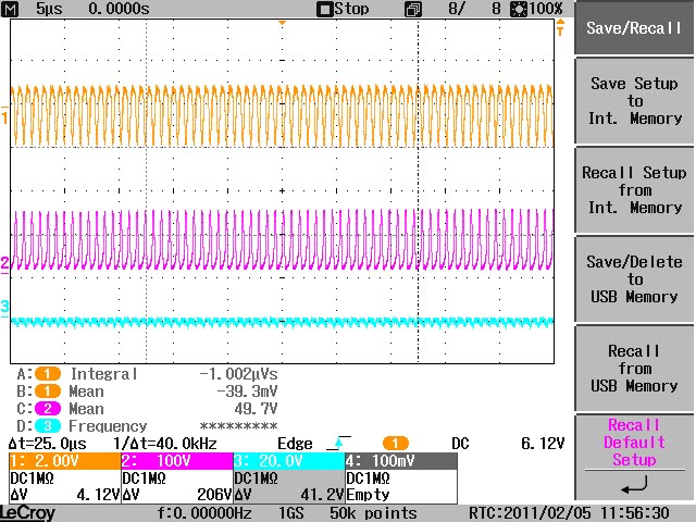

So here is a better switch circuit. I've spent some considerable time tweaking the SWITCH-based circuit to exhibit wave forms very close when compared side-by-side to the IRFPG50-based circuit. Both schematics are below and show the same "external" component values. The ringing in the "SWITCH" circuit was not tweaked to the exact same frequency, but it is close enough for demonstration purposes. Other than that, the traces follow quite closely.
The attached pictures are pretty much self explanatory, but feel free to ask about anything.
With reference to Vbat_diodeOUT.png, it would seem that with the body diode intact, the "Vbat" trace should not go anywhere near the 0V line (as shown by the green trace, which is the IRFPG50 circuit). The red trace (SWITCH CIRCUIT) however dips even further, to below 0V when the body diode is removed.

If you'd like to see a comparison of any of the wave forms with the actual IRFPG50, including the "gate" or VGS, just ask. You may be surprised at how close this comes.
Those capacitors should be there for the switch model to represent what is there in the real circuit. As a switch, this "model" seems to work quite well actually. Of course this model is not going to work if you try using this switch model as an amplifier or anything that uses the device in any other mode other than full cutoff or saturation.
Request a wave form....any wave form of the two. ;)

I wonder if Rose would be so kind as to show us a scope shot of VD, the Drain voltage?
Thanks in advance ;).
.99

Poynty - we did do a waveform directly across the load resistor - courtesy a very special little DSO. Here's the link. (Blog 54. I see I've incorrectly numbered two of them the same. In any event. You'll see which is which)
I appreciate the response, however, I am asking for a scope shot of VD (the MOSFET Drain voltage). This is not the same as the voltage across the load resistor. So far there are no scope shots of VD. What has been made available thus far, are scope shots across the shunt, scope shots of the battery line, and scope shots of the MOSFET Gate.
Please place the scope probe on the MOSFET Drain pin, and the gnd lead on your gnd bus. Done.
.99
