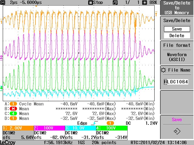

I am only half-following this thing.  In Rosemary's latest post the new set of DSO captures yields the same miraculous conclusion:
The data dump taken off the multiple waveform screen shows a mean average current flow of -0.49 amps (negative ie. back to the battery) Not as dramatic as was seen yesterday.
If you know your Superman comics and are a Seinfeld fan then this smacks of the Bizarro World.  In the Bizarro World the world is shaped like a cube and not a sphere.  You put your money in the bank and you expect to lose money and not gain money from the interest.
The Bizarro World (also known as Htrae) is a fictional planet in the DC comics universe. Introduced in the early 1960s, Htrae is a cube-shaped planet, home to Bizarro and his companions, all of whom were initially Bizarro versions of Superman, Lois Lane and their children. Later, other Bizarros were created to add to the population including Wonderzarro, Bizarro Flash, "the Yellow Lantern", Bizarro-Kltpzyxm and Batzarro, the World's Worst Detective.
In the Bizarro world of "Htrae" ("Earth" spelled backwards), society is ruled by the Bizarro Code which states "Us do opposite of all Earthly things! Us hate beauty! Us love ugliness! Is big crime to make anything perfect on Bizarro World!". In one episode, for example, a salesman is doing a brisk trade selling Bizarro bonds: "Guaranteed to lose money for you". Later, the mayor appoints Bizarro No. 1 to investigate a crime, "Because you are stupider than the entire Bizarro police force put together". This is intended and taken as a great compliment.
So in the Bizarro World when you hook your battery up to a resistive load you get current flowing into the battery and not out of the battery.  Old Rosie has never once mentioned anything about double-checking this measurement because you never double-check measurements in the Bizarro World.
Also, Rosemary's possible explanation for how to explain this phenomenon is in post #67 in all its glory.  That posting is right out of the Bizarro World.
It will turn out that the negative current measurement was all a big mistake!  Gosh! Darn!

Rose, I am curious;
Have you ever stopped to wonder why, when the MOSFET switch is ON, your scope shot shows zero current through the shunt resistor?
This can be verified by the fact that the power trace also shows zero power when the switch is ON.
That really plays into the "Bizarro" angle indeed.  I had scrutinized earlier captures and I thought I saw some DC current show when the MOSFET was supposed to be switched on.  In looking at some of the more recent captures it looks like there is no current flow when the MOSFET is supposed to be ON.
So what does that mean?  The ON-OFF polarity is confused again just like we saw nearly two years ago?  When the MOSFET is supposed to be OFF we have some positive feedback inducing an oscillation?  Or, when the MOSFET is supposed to be ON, some sort of feedback mechanism is causing the chopping of the MOSFET ON cycle.  The DSO is doing a polarity reversal somewhere?
The bottom line is that this this circuit consumes power from the supply battery and current flows out of the battery and into the load and the power consumption is positive.  In addition, the circuit goes into an oscillation due to a combination of some sort of positive feedback and capacitive and/or inductive circuit elements.
The only question is whether or not the "experts" will be able to figure this out as well as make proper measurements.  The elephant in the room is the fact that the shunt voltage and the apparent battery voltage have huge voltage oscillations associated with them and any undesirable and very small phase errors in the measurement will throw everything out of whack and make it look like the current and power consumption is negative when the truth is that both are positive.
The whole thing is a tempest in a thimble.

Some comments about Rosemary's first new DSO capture:
So this is roughly a 38 uS / 26 KHz gate signal.  The gate signal is being being provided by a function generator and the frequency is relatively low.
So why is the gate signal so miserable and drooping with an exponential decay?  I can't fathom it, it almost looks like it is a capacitively coupled signal that's too slow for the coupling.  Why is there a decay at all, when the input to the MOSFET is an open circuit after you charge the gate capacitance?
A 26 KHz square wave provided by a function generator should look like a pretty clean square wave if you ignore the spurious oscillation for a second.  We should be seeing a clean square wave with the spurious oscillations superimposed on it when the gate signal is low.  We are barely seeing a semblance of that.  I'm baffled and what about the university lab "experts?"  Surely they must be concerned about the abysmal condition of the gate signal?
Then there is the "elephant in the room" question:  There is apparently no current flow when the MOSFET is supposed to be ON.  At least at the beginning of the distorted gate ON signal the gate voltage is high, but no current flow is seen.  I also note that the drain voltage remains high when the gate voltage is high.  That doesn't make sense, the drain voltage should be low when the gate voltage is high.  This is in agreement with the shunt resistor showing no current flow.  So what's gives here, the MOSFET only appears to be switched on when the spurious oscillation takes place?
I defer to anybody else to enlighten me here because I am stumped.

Posts: 1888
The second new DSO capture:
So the big revelation here is that the drain voltage is almost identical to the battery voltage.  The oscillation frequency is about 1 MHz which is not particularly high in frequency at all for digital logic.  I have a feeling that that's not considered super fast even for a MOSFET but I will defer to Poynt and others on that.
One more time I can't fathom the drain voltage and the battery voltage being nearly identical.  The inductive resistor sits between the battery positive terminal and the MOSFET drain terminal and we are supposed to be seeing a voltage drop across it.  Can the battery probe be in the wrong place?  Are the batteries nearly discharged and they are super high impedance and we are operating in the "extreme fluffy" zone?  Is the 1 MHz oscillation high enough in frquency to just bypass the inductive resistor because of the stray capacitance associated with it?
The high voltage spikes have to be coming from an inductive component somewhere.  I assume that it's the wire between the battery positive terminal and the inductive resistor itself but I am not sure.
I also can't think of an explanation for the current apparently going negative during this time with those negative spikes.
I am not an expert on MOSFETs, but it almost looks like the MOSFET is being switched on from a small puff of charge that charges the gate capacitance for about 0.4 uSec before it dissipates and then the cycle repeats itself.
I am pretty baffled again.
Ultimately, I think that all of this is explainable and some of what we see in these DSO captures is not really what's happening.  The limitations of the equipment and the people using the equipment always are factors that you have to consider.  There is a form of "uncertainty principle" at play also.  There is simply no way that the net current is negative.  This is an absolute that could be proven with a capacitor-based low-pass-filter setup to measure the supply current.
MileHigh

Rose,
Thank you for the scope shots including the VD trace.
Yes, it is indeed strange that the Drain voltage trace would appear to be quite similar to the Vbat trace. There should be an offset of your Vbat voltage when looking at Vbat, yet there is none. There should be a measurable shunt current when the MOSFET is on, yet there is none.
May I suggest that someone from your team trace out the build while comparing it to your schematic? Something regarding the wave forms is not quite right, and leads me to believe that something is not connected as it should be, assuming that your new circuit is essentially the same as before, minus the 555 circuitry. We can not see many of the connections because they appear to run under the base of your apparatus. A photo of the top and bottom view would be quite helpful.
Just trying to help here Rose.

One thing that seems quite apparent now Rose, is that your MOSFET switch isn't "switching" at all.
Look at your SCRN0243.jpg from your blog #73. If the green trace truly is of the MOSFET Drain voltage, VD, then you can see for yourself that when the function generator is trying to go "HI" to turn on the MOSFET, the VD voltage remains at the battery voltage, which of course means that the MOSFET is either not ON, or only partially ON.
Can you explain why this is?
.99
PS. This confirms that there is indeed no shunt current when the MOSFET is supposed to be ON, as I mentioned already a couple times.
