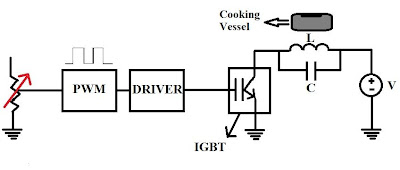

My dear exnihiloest,  in my humble opinion, you are:
  1) wrong about resonance,
  2) clueless about resonant converters,
  3) and simply too proud to admit you are wrong,
INMO, Dumped gave you a free and accurate psychological assessment!  Read it and learn from it, so you can better your life.
I joined this discussion of the Gegene based on tinmen's results and posts of the induction cooker schematic.  You came out accusing and said over and over that"  "there is no resonance to speak of"   and now you proved to us without a doubt, that you are not familiar with resonant converters.  You can twist my words all you want and copy and paste off the internet, but if you have no knowledge you don't know what to copy and paste, so you paste unrelated circuits, showcasing your ignorance for all to see.
You want proof?    See image bellow.
Farmhand,  I prefer you over EX,  INMO he should take a vacation.    :P
Paul-R   sorry I had to do one more feeding of the monster!   (by a monster! ) :D
WW, my head is all bruised up, I need a band aide!   >:(

Posts: 1504
Your opinion doesn't make science nor technics. I gave strong technical arguments that the resonance is not significant in the gegene.
You didn't challenge them, you can't because these arguments are right. Instead, you make a projection and attack me personally, not what I say and that passes over your head.
Your opinion about people is not humble, it is as stupid as about technics and resonance, it is as peremptory as unfounded, and moreover here, it is out of topic.
In absence of knowledge, "opinion" is only what you have. Your opinion has strictly no interest for a technical domain. If you search for an escape valve, consult a psychiatrist.

Where this question of resonance started was post 110 by dumped-Quote: As an electronic device, the Induction Cooker
is not really unique.  It makes use of the well
established principles of LC resonance and
near field loading of a Tank to induce eddy
currents into metallic surfaces.
Your reply was post 112 Quote: No, it doesn't.
Post 115 by Dumped Quote: Perhaps you'd care to elaborate?
Your reply post 119 Quote: There is nothing to elaborate.
The electronics is known. The typical schematics of induction heaters have already been presented here and you can get them every where on Internet.
Where do you see "resonance"?!
So this is where it started Exn,and had nothing to do with the GEGENE at the time.It was about resonance within the induction cooker.

Exn-The question was never just about the GEGENE setup,the question of resonance that you put forth your argument was about the induction cooker itself.
is not really unique.  It makes use of the well established principles of LC resonance and near field loading of a Tank to induce eddy currents into metallic surfaces.
I agree, Tinman, you're right. Nevertheless it doesn't change much. If resonance had been the principle of induction cookers, it had been the principle of the gegene (outside the question of OU).
The principle of an induction cooker is... induction  :) which is only eddy currents, and eddy currents don't imply resonance. The metal to heat acts as a secondary coil+load coupled to the coil inside the cooker. This is a transformer. A transformer doesn't need to be resonant to work and generally, it's not.
