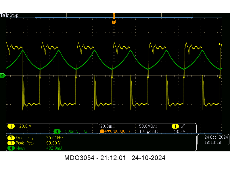

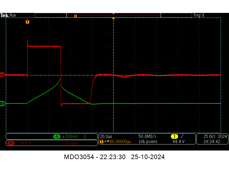

partzman
This is a demo of a 7 cycle burst of the circuit shown in the schematic below that is a follow up on my post #512
This example is OU and can be extended for more cycles however, with the 100 ohm load, the energy supplied to Vload will eventually increase the voltage on Vload after X number of cycles to a point where the dV on C1 will not have enough potential to force D2 to conduct.  At this point, the input energy is wasted as no output energy will be developed.  So, Vload must be discharged back to the starting level and repeat.  In a final product utilizing this technology, a processor would supply the necessary timing and duty cycles to allow continuous operation with varying loads.
The schematic shows the values used.  Note the changes in V1 and the primary turns.  This all still results in a V/t=3.2v .  The M1 mosfet switches in the 100 ohm, 1%, non-inductive load resistor at the beginning of the entire cycle and disconnects the resistor after ~217us.
SP1 shows both the current on CH4(grn) and voltage on CH3(pnk) for the Vload line with the conventional current flowing into Vload.  The Math(red) channel shows the mean power to be 1.946W over 223.4us resulting in an energy level UVload=1.946*223.4e-6=435uJ .  Note the negative power levels during the time C1 is following the negative dV on the primary.  During this time, R2 is drawing power from Vload creating the reverse current flow.
Sp2 shows the mean current in R2 in CH4 of 220.3ma over 223.4us.  This equates to an energy level of UR2=.2203^2*100*223.4e-6=1.084mJ .
SP3 shows the Pin on the Math channel to the primary including the less than optimum 3/4 bridge drive circuitry to be 1.593W over 231.8us .  This equates to a Uin=1.593*231.8e-6=360uJ .
Therefore, we see a COP=(435+1084)/360=4.11 .
SP4 simply shows the starting and ending voltages on C1 measured at VC1 with CH3 to be essentially the same.  This is requiring more study to completely understand as far as I'm concerned.
There is only one source for this excess power IMO and that is the aether during each charge separation or dielectric induction event of C1.  I am more than happy to hear other explanations or to hear of any missed calculations, etc.

I use a battery operated FG as input signal (DC square wave 30kHz around 50% duty cycle) as to not run into ground loop problems when using the (grounded) scope probes later on.
I use 12V (minus isolated from ground) on the MOSFET drivers and CD4049 and 40V (also minus ground isolated) on the P-channel source (the zener in the P-channel MOSFET gate is 12V).
i did not succeed in finding the correct core for L1 (2.5mH with 20 turns) so i had to increase the number of turns to about 150 to get this 2.5mH inductance.
The resulting voltage across this L1 is not the 10V DC square wave seen in PM his screenshots (yellow), but an AC square wave doubling the 40V input voltage.
So i made a LTspice simulation of this circuit i have USING RANDOM AVAILABLE P- AND N-CHANNEL MOSFETS FROM THE LIBRARY, see here:
This simulation confirms the AC square wave i see when using a 2.7mH inductor as L1.
The simulation is attached below.
When i get the same DC square wave signal on L1 as shown by PM i will be able to continue building the Vload circuit and start making measurements from there.
Here the voltage across (yellow) and the current through (green) L1 on my bread boarded circuit:
I found and now use a Finemet core FT-3K50TS with an OD = 63mm and AL=27.1uH/N2 at 100kHz with 14turns measuring 8.7mH

Now, concerning the voltage across L1 using the 3/4 Bridge.
I now drive the circuit using my Rigol FG in burst mode (1 pulse per 100ms).
As the Rigol has a grounded lead, i cannot directly measure the voltage across L1 using a single probe as its ground lead will short out the MOSFET, so i use 2 probes in differential mode and subtract the result using the math function.
Here is my result of the voltage across L1 (40V supply on the MOSFET) in red and the current through L1 in green.
So i have an AC square wave across L1 (+/- 40V).
The current trace shows saturation where the green trace curls up.
Can you confirm that you also have such an AC square wave voltage signal across L1?
