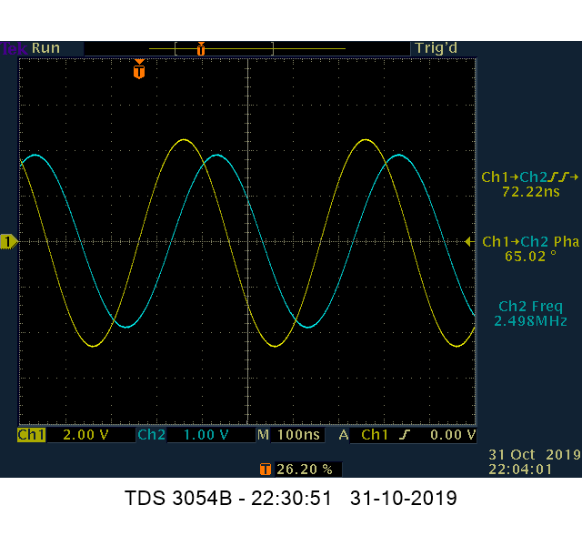

The csr route should solve the probe time delay problem.  It would be helpful if you could do one simple thing, and that is feed your FG onto the primary, load the secondary with your 100 ohm non inductive R and then measure the time delay across the MDT.  This will be about 35nS and it would be good to get this verified.
Using a FG (10vpp sine wave @ 2.5MHz) directly attached to the primary, and a 100 Ohm resistor only
across the secondary, i measure a 72nS time delay, see screenshot.
Yellow FG input signal,
blue signal across the 100 Ohm.

Concerning the "107ns @ 420KHz and 72ns @ 2.5MHz" time delays, it seems that the phase between input
and output is changing by frequency and thus the time delay.
It follows the below table (see screenshot 1 and 2 for min. and max.):
100KHz: 118ns / 4°   (so input and output almost in phase).
500KHz: 115ns / 21°  (our 117ns @ 420KHz)
1MHz:    105ns / 37°
2MHz:    81ns  / 58°
2.5Mhz: 72ns  / 65°  (our 72ns @ 2.5MHz).
