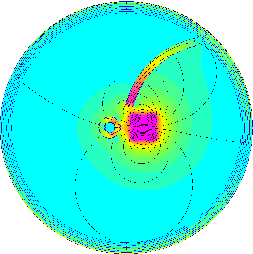

So I have been running some FEMM simulations and noticed an interesting effect which others have talked about in the past, see: http://jnaudin.free.fr/steorn/html/orboeffecten.htm
But that's all I will say about that source as to avoid having to name that cursed company  C.C.
Now where this came from is knowing that Magnetic flux is always conserved and you can say that inductance*current (L*I) is always constant for non time varying magnetic system. This can be seen as equivalent to momentum, m*v in classical mechanics which is also always conserved unless a force acts on the system to change it. We can see this by simply removing the core from a powered solenoid, the current shoots up as it will want to maintain the flux it had with the core inside. Consequently the energy of the system also rises as L*I must remain constant, since the energy of the solenoid is defined by L*I²/2, the current rising will have a quadratic relation on the energy. The obvious source of this energy gain is your muscles that jerked the core out of the solenoid, as you would notice the core would very much not like to leave the center of the solenoid.
Now that is the basic theory aside. Obviously this is nothing new. Has been discussed in the past under different names such as "parametric transformers", "parametric resonance" and so on. This research has died down since the 70's but someone in academia quite recently reignited intrest in this field:
https://www.researchgate.net/profile/Andres-Revilla-Aguilar
Now this brings me to the FEMM simulation. Basically it's a toroid coil next to a magnet and in between moves a piece of iron to shield the PM field. When the shield reaches TDC the toroid is powered on, in this state the toroid has maximal inductance, now as the shield moves away and the toroid is exposed to the magnetic field, it will lose quite a bit of this inductance due to core saturation thus making the current rise to keep the flux constant inside the coil. This consequently will increase the magnetic energy, quadratically, of the coil.
Attached you also see a torque table that shows the torque difference for the shield moving to and away from the coil/magnet. What surprised me was the small difference in torque you get on the shield when the toroid being switched on and off. This may be significant as the inductance can reduce by as much as 10 folds due to the saturation of the PM field and thus end up with two orders of magnitude more energy for a very small mechanical penalty. FEMM sadly does not support such dynamic inductance calculation but this can be confirmed quite easily with a capable LCR meter. On the other hand FEMM is quite accurate at force calculations which make these results look promosing.
Sim specs:
Core: BH-curve modeled after metglass cores (attached), OD=40mm, ID=20mm
Coil: 10A, 10turns
Magnet: N55 neodymium magnet
Shield: pure iron with linear permeability
I used lua scripting in FEMM to perform the stepwise simulation.
TLDR: L*I is always constant, when you lower L, I has to rise proportionately, thus the total magnetic energy will rise quadratically due to L*I²/2. Parametric transformers have been under active research recently. FEMM simulation shows that little mechanical energy is expended for potentially large induction changes of a toroidal coil.
EDIT: Might not be obvious but there is an mp4 video showing the simulation between the attachments.

Posts: 2306
Hi Broli,
An LCR meter won't give correct answers for saturated cores hence any results there must be used with caution.  FEMM can support dynamic inductance features by using the flux linkage available in the Circuit feature.  Thus you can step through a current rise recording flux linkage at each step.  You can then chart this in a spreadsheet and view its non-linearity.  You can also integrate this Flux v. Current quite accurately using Simpson's rule and that will give you the co-energy.  Subtract that from the rectangle formed by Ipeak*FLUXpeak and that gives you the energy needed to charge the inductor or the energy regained on discharge.
For your experiment you could create the chart as shown in the image below where the Flux v. Current follows a CW loop.  The area within that loop is the energy gained from the shield movement.  I have just done FEMM runs with something similar to your set up and the result is that the energy gained is very small (it would be quite significant if the shielding action could run at high frequency, like 10's of KHz).  I get a few hundred microJoules.  The torques are quite significant like several Nm and looking at the expected few hundred microJoules energy lost in the in-out movement it is down in the noise.  So it is not conclusive as to whether an OU gain is possible.  I have done similar things in the past moving the magnet towards the toroid and that has never shown OU.

Wrong thread for this topic but a quick FEMM simulation shows that the effect of the magnet is minimal as it only affects a small area at one end, so I don't see what you are getting at.  It certainly does not have an effect at the other end where the aluminum plate is attached.  A non Halbach magnet will have a greater effect.
Posts: 372
@Smudge here's something wrong that I discovered about FEMM, apparently it does not consider the amount of turns of a coil when calculating the flux linkage. So if you make use of turns (as I did) you have to multiply this with the flux linkage to get the final correct induction. I was getting abnormal low inductance ranges for the specs I was using and that explained it. Will continue with trying to get the inductance differences of the above simulation.
I don't know how you came to that conclusion, FEMM has always dealt with flux linkage correctly.  I have just done a simple solenoid and used the FEMM Circuit facility where I put a conducting sheath either side of the core.  One side is Circuit 1 and set to 1 turn.  The other side is Circuit 1 and set to -1 turn.  Then with Circuit 1 set to 1 amp I get 1.1908E-8 Weber flux linkage so for 1 turn that is the actual flux.  Next I reset the conductor sheath to 10 turns and -10 turns, still at 1 amp.  The flux linkage is now 1.1908E-6.  That is the correct value as the flux is now 10 times greater and the flux linkage is 100 times greater.
Posts: 372
@Smudge, you are correct that is my bad for reading the results wrong.
