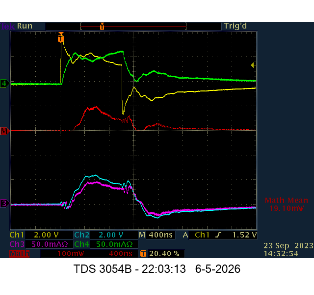

For what its worth, i switched to the TDS 3054B scope which has 2 P6302 current probes attached besides the 2 voltage probes.
It was powered on for some hours and a fresh calibration was done.
I still have the 100pF delay lines active.
I hooked up the yellow voltage probe and the green current probe to the primary.
I hooked up the blue voltage probe and the purple current probe to the secondary which has the 50 Ohm load resistor.
The FG was still set at 1us pulse with a 1kHz prf and 5V DC.

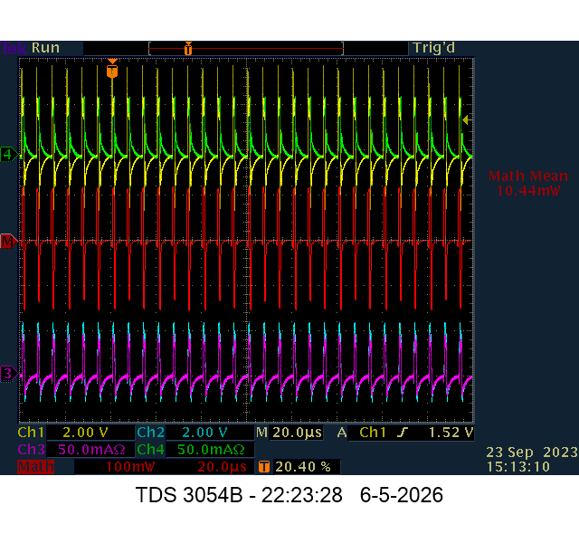

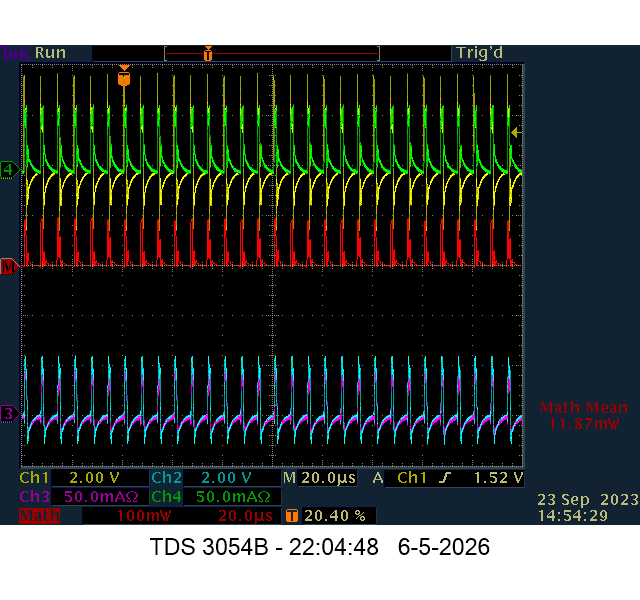

As this scope can make 1 math calculation at a time, i took 2 screenshots with the math function (red trace) set to first calculate input power yellow x green over 1 cycle (screen) followed by the math function (red trace) calculating the output power blue x purple also over 1 cycle (screen).
Results can be seen here:
Input power 1 cycle
Output power 1 cycle
Then i increased the shown cycles and set the FG to prf 150kHz and toke the same measurements over multiple cycles:
Input power multiple cycles
Output power multiple cycles
I rechecked by swapping the current probes and redo the above measurements which showed very similar results.
