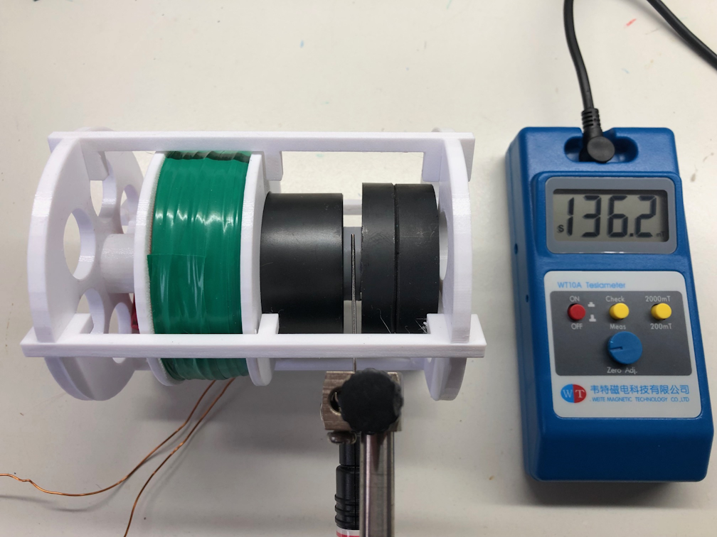

The fields are not homogenous, as far as i can see as moving the probe from OD to ID shows many fluctuations.
Also measuring a single magnet across its surface shows many different readings.
Another problem is the positioning of the probe when probing inside the gap as we have many "degrees of freedom" to control.
This picture shows me having the probe in what i call the 0° position:
Let me double-check on this as i am sure i found a 0mT spot with the probe in 0° position while running 8A through the coil.

PW, verpies,
for details on my device see here:
Data left to right;
2 stacked ringmagnets each 57 x 21 x 13mm (OD ID H),    Soft core (underneath the coil) 50.5 x 25 x 28.5mm (OD ID H),   Soft core 50.5 x 25 x 28.5mm (OD ID H),   2 stacked ringmagnets each 57 x 21 x 13mm (OD ID H)
Coil data:
coil former OD 53mm
Coil width 27mm
coil thickness 11mm
530 turns 0.8mm magnet wire
88m length
3.5 Ohm
No copper foil is present.
Step 1:  Measure the surface field of the magnet side of the gap with the coil deactivated.  Place the probe's measurement face directly against the surface of that pole piece.  Note the reading.
With all 4 ringmagnets stacked together on the right side of the device i measure 180mT at the surface (OD) of these magnets in the gap, but 170mT when moving a few mm inside the gap to match the OD of the soft core.
See also this earlier measurement here:  https://www.overunityresearch.com/index.php?topic=4515.msg108422#msg108422
Step 2:  Remove the magnets from the sausage.  Position the probe to make a surface field measurement of the pole piece on the DC coil side of the gap.  As above, place the probe's measurement face directly against the surface of that pole piece. (pick a location that is directly opposite from where you made the step one measurement).  Ramp up the coil current and see if you can attain the same (or greater) field strength as measured in step one.  Note the amp draw.
With the 4 magnets removed and measuring the flux on the surface of the 2nd core at the OD in the gap i measure 115mT (max.) at 7.6A current (max).

I am probably not expressing myself clearly enough, sorry for that, but i did make my latest measurements on the "face" of the pole pieces.
But as the strongest readings are at the outside of the core / magnets, i referred to this outside as OD, so here a picture of where i measured the above readings:
Concerning: "the probe measurement axis parallel to the sausage axis, which I believe you call the 90 degree measurement for some reason...", i from now on will call that the 0° position.
I will do some experiments with fewer magnets to see if i somehow can "null the field with the DC coil".
I removed the left 2 stacked magnets leaving only the right 2 stacked magnets.
Measuring with the probe in the middle of the gap halfway the OD / ID of the soft core in the (new) 0° position, see picture, where the coil is DEACTIVATED (136mT).
When activating the coil at max 8A, the reading is reduced to 70mT:

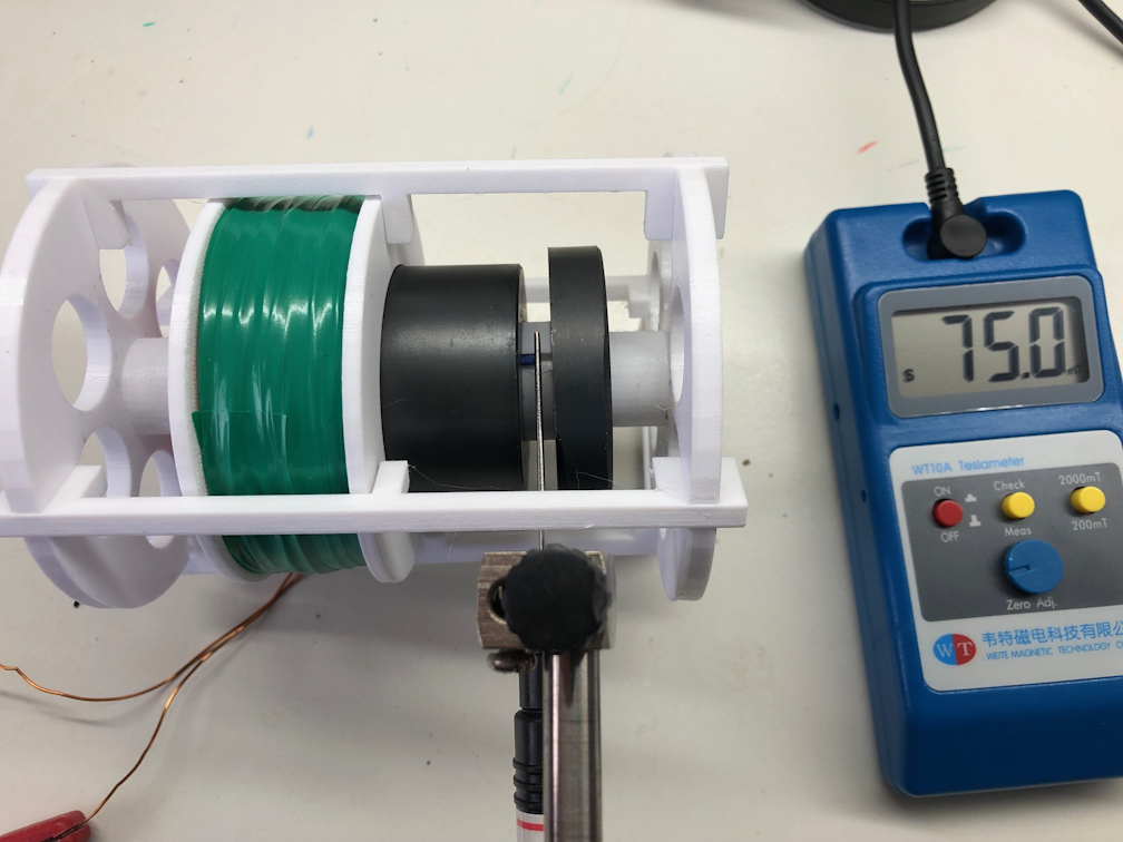

Then i removed one of the 2 right stacked magnets, leaving only one (the weakest).
Measuring with the probe in the middle of the gap halfway the OD / ID of the soft core in the (new) 0° position, see picture, where the coil is DEACTIVATED (75mT).
When activating the coil at max 8A, the reading is reduced to 11mT:
So nearly there (0mT), so looking for an even weaker ring magnet............

I found a weaker speaker magnet which i put in as the only magnet,
Same setup as before, measuring 60mT with the coil deactivated, see picture:
Around 6A through the coil the meter reads 0mT.

Now that you can null the field, measure the radial field (what we are now calling the 90 degree reading with the measurement axis perpendicular to the sausage axis) with and without the DC coil activated with the current necessary to achieve the 0 degree null.
PW.
PW,
it depends on what position (height) the probe needs to be.
When at the same height as previous done (halfway the OD / ID of the core) i can set the reading to 0mT with deactivated coil and this will stay low (max 8mT) when activating the coil with 6A.
But when increasing the probe height to be higher than the OD of the core (5mm) then we have a reading of 25mT with deactivated coil and 57mT with 6A through the coil.
For this latter position see this picture:
