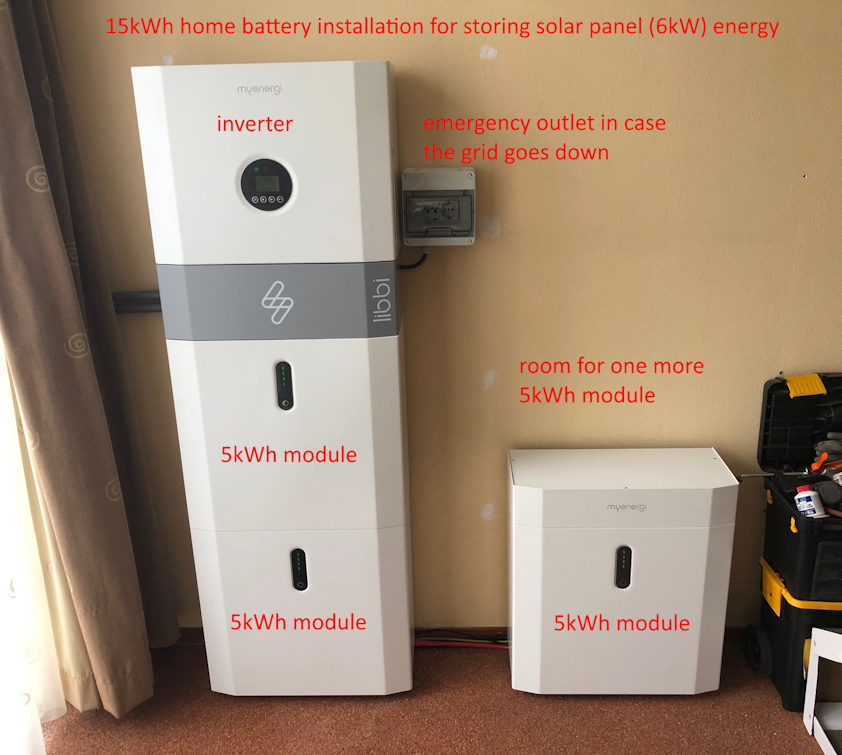

2 days ago i have had installed a 15kWh solar battery system hooked up to our 11-year-old 6kW (24 panels of 250W) solar panel.
The idea is to collect the free solar power during the day to use it in the evening.
This was driven by the notion that the current netting (netting the supplied energy delivered to the grid with the energy taken from the grid) will be stopped in the near future here in The Netherlands.
We have / had a 50% netting, so we did not pay for any electricity these last 11 years (we even often got a nice bonus at year's end).
Anyway, this is the battery system, which is tuning itself right now and seems to work as we expected it would:
We could add a 4th 5kWh module, totaling 20kWh of storage, but this will be decided after some time and only if needed.
With a daily consumption of about 7kWh we could last 2 days on a full charge, but this will change drastically nearing the wintertime as we have some infrared panels supplying additional heating in some rooms relieving the natural gas heating system.

Very nice setup you have there Itsu!
In September 2022 I bought and installed 6x 375W SunPower Maxeon 3 DC Black solar panels on my garage roof and then added a Solax 7.5kW inverter and 3x Solax 5.8kWh batteries. The panels will generate up to 2.5kW on a nice sunny day and around 500W on an overcast day.

Thanks Ifarrant,
so you have a dynamic energy contract with cheap nightly rates etc., well my provider (like 95% of them here) do not allow a dynamic contract when having solar panels, so i have a fairly fixed variable contract.
Need to look for another provider, i guess.
For now, we try to charge the batteries to full during the day and use it during the evening / night, which is no problem now (dropped overnight to 77% first day and 83% last night).
