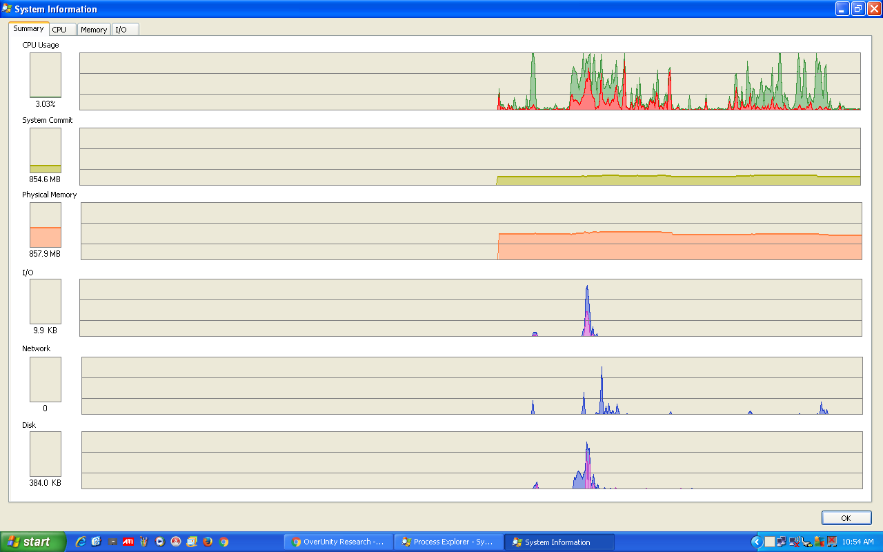

I am still having trouble loading pages.  The home page comes up immediately but anything else times out and takes 2 or 3 reloads to get it up.  This does not happen on my laptop running windows 8, only on my PC running XP.  I cleared my Chrome cache and that made no difference.  I downloaded the Autoruns utility and there is so much stuff there that I don't know what to disable and what to keep.  I tried disabling all the things I thought I didn't need, rebooted and still I have the problem.  It didn't occur before the change to a new server.  I also get the other problem, when trying to modify a post I sometimes get the start new thread page.  Maybe I'll just have to use the laptop all the time.
Can you post a screen shot of the autoruns screen, just press 'printscreen button on the keyboard and paste into paint, then save as a jpeg, resize if over 1024 pixels ( I do out of habit for forums). Those of us with xp can assist no worries. Others better than I for certain but I can help with some things. I'm curious I'll get on the xp laptop.

Posts: 564
Thanks to Verpies link I found this other utility as well Process Explorer- https://technet.microsoft.com/en-us/sysinternals/processexplorer
A screenshot like this (from windows 7 desktop comp.) during the time the issue is occurring might help. I wasn't able to reduce the size without bluring the figures and words. sorry. I only had this site open and a pdf in firefox as well as the utility.
This web site handles attached pictures very well for my purposes, I like the way it displays the attached pictures.
First shot is my windoze 7 machine. Second shot is my windoze xp machine. Something is up with the IO on my windows 7 machine, apparently. It takes a long time to start up and is a bit sluggish, old install, could do with an upgrade to doze 10. I'll have unlimited Home Broadband soon so I will do it then. Maybe. The xp machine has SSD while the 7 machine has a HDD. Maybe just windows 7-10 wasting power for me/us.
Last shot is windows 10 machine a 6 core 3500 Mhz, so 10% cpu usage is a fair bit really and the network usage is conveniently not given by windows 10 to the utility to show. I can see how The different windows versions use the resources differently. Makes me want to use xp to save power and network data usage ect. 10 is pretty good to use though after setting it up and killing all the data eating stuff. Still cannot turn off automatic updates which is a big no no to me.
I was using this site and doing other stuff when the shots were taken.
P.S. Windows 10 was actually updating. I just got the notification to restart due to updates are installed. grrrrrr. Just for curiosity the last shot shows the system usage during the update and when it stops.
