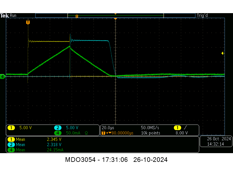

Now, concerning the voltage across L1 using the 3/4 Bridge.
I now drive the circuit using my Rigol FG in burst mode (1 pulse per 100ms).
As the Rigol has a grounded lead, i cannot directly measure the voltage across L1 using a single probe as its ground lead will short out the MOSFET, so i use 2 probes in differential mode and subtract the result using the math function.
Here is my result of the voltage across L1 (40V supply on the MOSFET) in red and the current through L1 in green.
So i have an AC square wave across L1 (+/- 40V).
The current trace shows saturation where the green trace curls up.
Can you confirm that you also have such an AC square wave voltage signal across L1?

I also lowered my voltage on the MOSFETs to 12V (from 40V) and measured the scope points you pointed out (yellow the P- and N-channel MOSFET junction, Blue the other junction) compared to ground and this is the result:
Pulse frequency is 13kHz at 100ms repetition rate, and we now see similar voltage traces like in your screenshot, only my current is shown at 50mA/div. (probably due to my CH4 being at 50 Ohm).
Induction of L1 = 4.7mH (10 turns).

Now you are ready to place a cap in the core!
my purple is your pink  :)
Here my corrected screenshot using your probe positions:
Yellow is the FG input signal
Pink is the L1 coil leg (P-channel side)
Blue is the L1 coil leg (schottky diode side)
Green is current through L1
All referenced to ground.

OK, I would recommend you check the current in the primary as it is probably showing some core saturation.

When your green channel measuring current in the primary begins to increase from a linear ramp even a little bit, the core is beginning to saturate.  When your PS is 40v DC, your core is greatly saturated.  As the core saturates, the current in the primary will increase and no longer be linear, the voltage across the secondary (in this case the capacitor) will decrease, and there will be flux outside the core depending on how heavy the core is saturated.  In your case, you can see the voltage across the cap decrease to zero and below plus your 40v DC supply is also decreasing in voltage.
I'm not sure what you mean by "runaway" in your last question?  Could you be more specific?
thanks, so the saturation indeed seems to be the most logical after all.
What i meant with runaway is the lack of "dead time" between the MOSFETs being driven (top left P-channel and bottom left N-channel) causing a momentary short (both active), but that would be the case all the time, not only when increasing the voltage above a certain point.
Why you can run with 64V on the MOSFETs without saturating the core (L1 = 2.5mH) while my core (L1=4.7mH) gets saturated at 35V (and saturation at 24V when my L1 is also 2.5mH) is not clear with me, but probably has to do with the makeup of the used core.
Because approaching the V/R limits curves the inductor current in the opposite direction to saturation - it can mask the saturation.
Shoot-through current.  An extreme form of crossover distortion.
The saturation of our inductors will depend on the applied voltage, inductance, and dt or the amount of time the voltage is applied to the inductor.  Up to now, you have been discharging the "C" with a known inductor.  When you begin to use "C" to charge a Vload, you will notice the required dt will be short due to the small lead inductances creating a relatively high resonant frequency.  Then you will find your core will normally not enter saturation.
