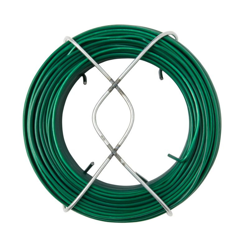

Another option to consider is PVC coated garden wire.
Posts: 199
I made such a coil of steel wire for fences. PVC and other rubber/silicone coating.
The effect was that the inductor heated the steel wire and nothing happened. You may need to use instead of 'kacher', e.g. spark gap with a capacitor. I haven't checked this variant.
Diall PVC steel wire 1.05-1.4 mm 50 m green
https://media2.castorama.pl/is/image/CastoramaPL/drut-stalowy-diall-pcv-1-05-1-4-mm-50-m-zielony~3663602918509_02c?$MOB_PREV$=&$width=64&$height=64
https://sklep.siatki-stal.pl/10645-large_default/drut-naciagowy-powlekany-fi-36-mm-dlugosc-50-m.jpg
