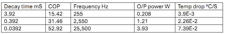

Posts: 400
What size should be core,to we could allowed to heat and cool it twenty five thousand time per second ?

Posts: 2343
I stated the ring-core dimensions as having a cross section area of 1 square cm and a magnetic length of 15cm.  And it is not heated and cooled multiple times per second, it is cooled each cycle resuting in a continuous cooling that needs to be offset by thermal conduction from a heat source (hopefully a ground source or air source at ambient temperature).
Posts: 400
So I don't fully understand how it works. I admit it. C.C
