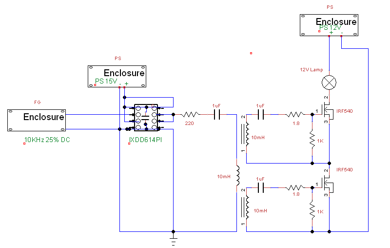

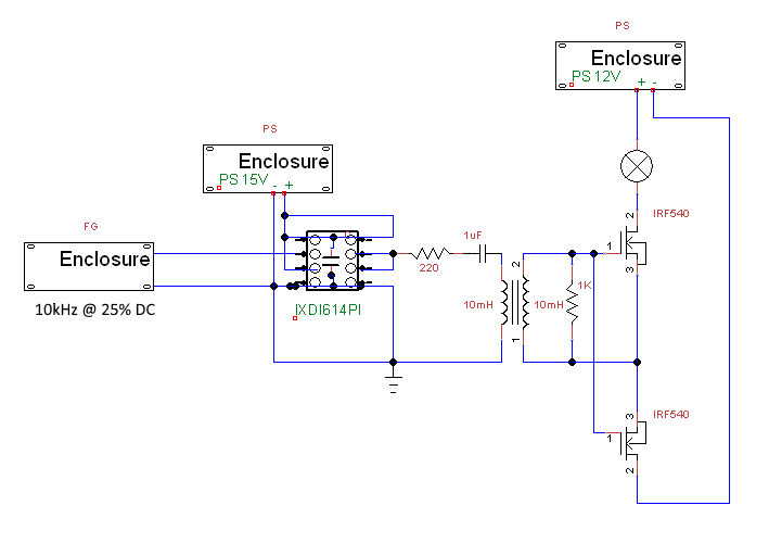

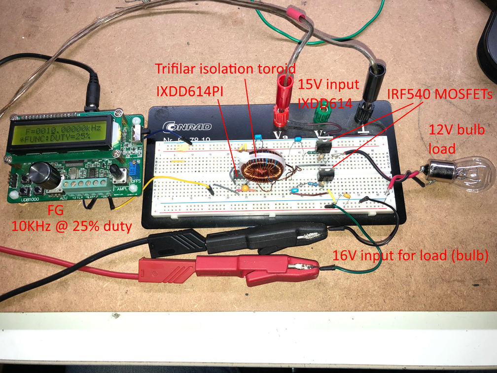

While waiting for parts, i decided to throw together a quick breadboard setup of the both discussed setups meaning Jeg his setup see this:
and the Bidirectional setup proposed by Gyula here:
The breadboard layout looks like this (here Jeg his setup is shown):
So i use some low voltage IRF540 MOSFETs for now and a 12V bulb as load, just to see if things work.
Both setups seem to work equally well in this low voltage layout.

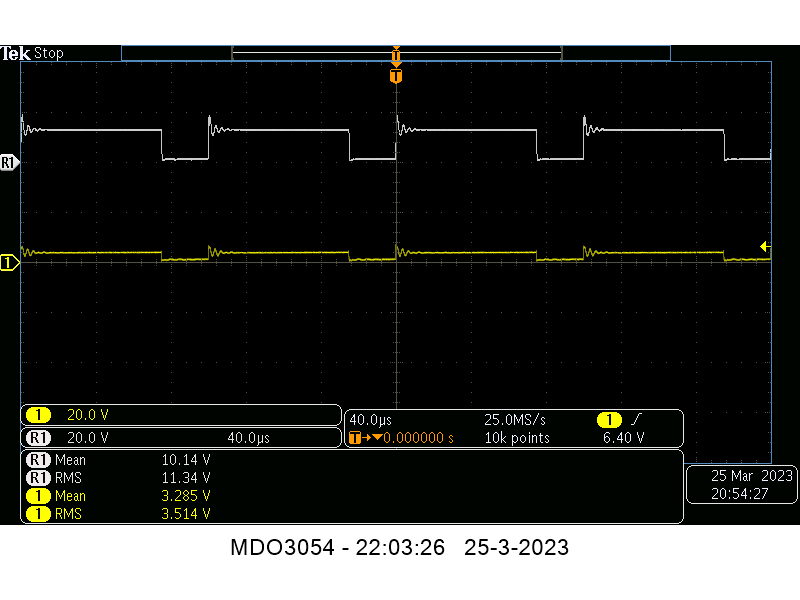

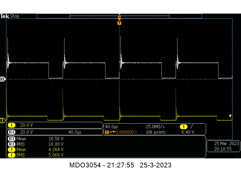

There are some differences and agreements in the drain - source signals, see these screenshots (1st is from Jeg his setup, 2nd is from the Bidirectional setup):
Both seems to show that the upper (white trace) MOSFET is doing more work looking at the mean and rms voltages (current through both MOSFETs should be the same)
and indicated by the temperature meter showing some 5 degrees C more on the top MOSFET.
But in the Bidirectional setup it shows the top MOSFET having more voltage across the drain - source compared to Jeg his setup.
From the above experiment (and after increasing the voltage across the MOSFETs / load to 40V), it seems that the voltage across the both MOSFETs is not equally divided across them.
The top MOSFET is taking the most (80 to 90% roughly) of the voltage across it, so when we need to work with 3000V it seems that the top MOSFET will get some 2400V across it.
