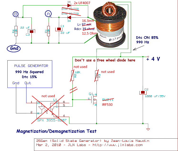

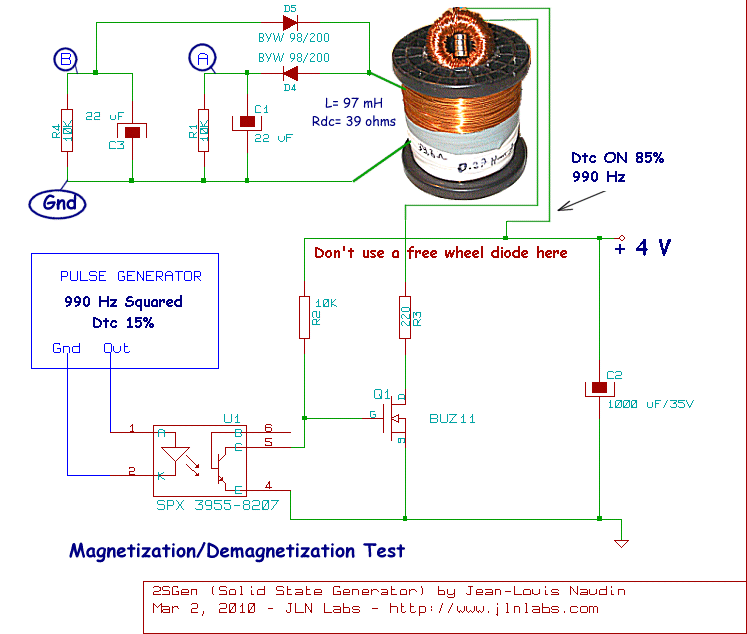

Its a method used by JL Naudin in his 2Sgen project (Solid State Generator) from 2010 shown here: http://jnaudin.free.fr/2SGen/html/s2genep7en.htm
JL Naudin references a paper written by Nikolay E. Zaev where the theory behind this is explained: http://jnaudin.free.fr/2SGen/images/demag.pdf
Jagau mentions a difference ratio (calling it the: "magnetic power coefficient") of 27.77, while JL Naudin found 13.7 and N Zaev 16.3.
The measurement uses a 10K load resistor with a 22uF capacitor parallel on both the magnetization as the demagnetization phase, see top part diagram:
Searching the web, i found an old thread on Overunity.com where this setup was mentioned and where the late MarkE showed that the claimed difference
should be zero:  https://overunity.com/13551/magnet-coil-cores-demagnetization-power-and-lenz-delay/msg425491/#msg425491
But that does not tell why there is a considerable difference in stored energy in the both 22uF caps, see my setup below where i measure:
(E = 1/2 * C * V²) magnetization energy (4.184V) =     0.19256mJ and
                           demagnetization energy (11.33V)  = 1.412mJ                   (using 22uF caps).

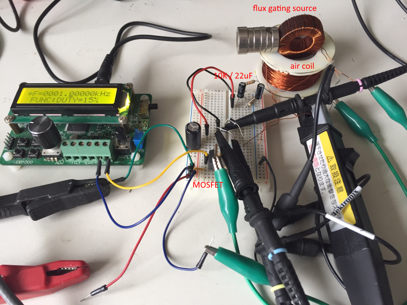

Anyway, i tried to replicate this setup by using a finemet (Nanocrystalline) FT-3K50T ferrite toroid as the flux gating source:
mu = 50K @ 1KHz
Coil 200 turns
L = 618mH @ 1KHz without any neo magnets attached
L = 395uH @ 1KHz with a stack of neo magnets attached
R = 1.1 Ohm
The air coil:
L = 16.3mH @ 1KHz
R = 12.5 Ohm
Using 2x UF4007 as diodes, 2x 10K resistors, 2x 22uF caps and an IRF530 MOSFET with 4V on drain see modified diagram:
i get the following voltages on the 2x 22uF caps:
4.184V (magnetization) and 11.33V (demagnetization) and thus a "magnetic power coefficient" of 7.33 (11.33² / 10K) / (4.184² / 10K).

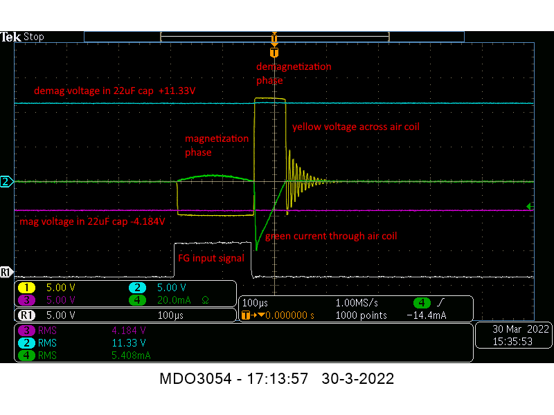

The screenshot shows:
White:  the gate signal into the MOSFET (1KHz @ 15% Duty Cycle)
yellow: the voltage across the air coil
green:  the current through the air coil
blue:   the DC voltage on the 22uF cap at demagnetization
purple: the DC voltage on the 22uF cap at magnetization
So its seems that we have more energy out of the air coil then was put in.

What MarkE showed and said is correct for what he was showing, and as he said it is basically a boost converter.
is this the correct way to measure the difference in energy going into and out off an air coil?
Yes it is the correct way to measure the in and out energy, by using the area, the difference is the pulse width, the voltage, and the current, as in boost converter.

I measured more accurate the several data using cursors on the scope and my Fluke 179 DMM, see table:
It seems the discharge time is much less (4.4us) then your estimate (8us), see screenshot where i zoomed in:
So the discharge energy is less then the input consumption!
But this shows uJ (micro Joules) while my aircoil charge / discharge energy shows mJ (milli Joules), so something is wrong here.

Quote from: Itsu on 2022.03.31, 12:53:58
OK, thanks for taking those measurements.  The discharge time was the major source of error in my calcs however, let's take your input energy of 457uJ and your discharge energy of 268uJ which leaves us with a net energy consumption of 189uJ.  Please note that the energy lost in the avalanche of the IRF530 does not to be that way.  The discharge energy could be captured in a capacitor of proper value at a voltage just below the level of avalanche.  This cap's energy would have to be periodically drained back to a/the power supply so the voltage remains below avalanche levels.  This is just one solution.
Then let's take the sum of your energy calcs for C3 and C1 of 193uJ and 1.412mJ respectively which equals 1.605mJ .  I see no other source of energy to your device so the apparent COP = 1.605e-3/189e-6 = 8.49!
To have a useful device from all this simply requires energy shuttling or transfer but even with additional losses, the COP would still be considerable.

Right, i agree,  but the overall COP was not the goal in the first place.
The goal is to show that in the air coil, the energy to create the magnetic field is less then the energy available when this magnetic field collapses.
My replication shows this is so, a real Solid State Generator, but one of the questions i asked in my opening post is if this method is the correct one
to measure the energy to build the magnetic field and to measure the energy in the collapsing magnetic field.
