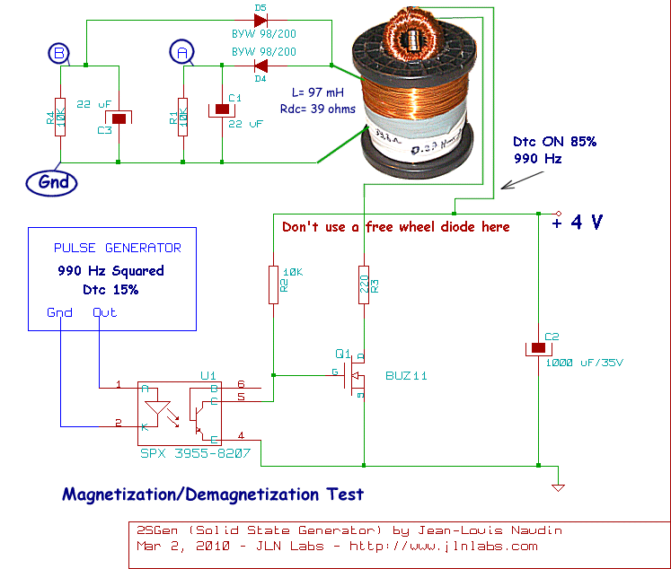

Its a method used by JL Naudin in his 2Sgen project (Solid State Generator) from 2010 shown here: http://jnaudin.free.fr/2SGen/html/s2genep7en.htm
JL Naudin references a paper written by Nikolay E. Zaev where the theory behind this is explained: http://jnaudin.free.fr/2SGen/images/demag.pdf
Jagau mentions a difference ratio (calling it the: "magnetic power coefficient") of 27.77, while JL Naudin found 13.7 and N Zaev 16.3.
The measurement uses a 10K load resistor with a 22uF capacitor parallel on both the magnetization as the demagnetization phase, see top part diagram:

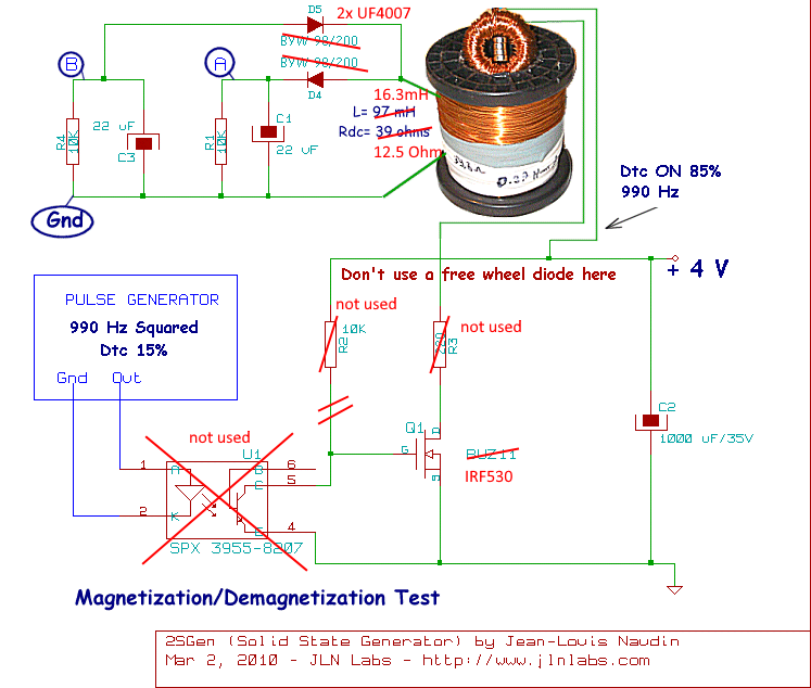

Using 2x UF4007 as diodes, 2x 10K resistors, 2x 22uF caps and an IRF530 MOSFET with 4V on drain see modified diagram:
i get the following voltages on the 2x 22uF caps:
4.184V (magnetization) and 11.33V (demagnetization) and thus a "magnetic power coefficient" of 7.33 (11.33² / 10K) / (4.184² / 10K).

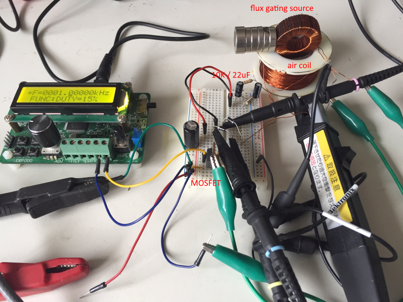

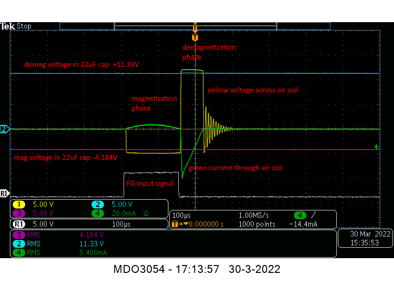

The screenshot shows:
White:  the gate signal into the MOSFET (1KHz @ 15% Duty Cycle)
yellow: the voltage across the air coil
green:  the current through the air coil
blue:   the DC voltage on the 22uF cap at demagnetization
purple: the DC voltage on the 22uF cap at magnetization
So its seems that we have more energy out of the air coil then was put in.
We do need to pulse the "flux gating source" with more power to achieve this, so overall COP below 1.

I measured more accurate the several data using cursors on the scope and my Fluke 179 DMM, see table:
It seems the discharge time is much less (4.4us) then your estimate (8us), see screenshot where i zoomed in:
So the discharge energy is less then the input consumption!
But this shows uJ (micro Joules) while my aircoil charge / discharge energy shows mJ (milli Joules), so something is wrong here.
Episode 6 here: http://jnaudin.free.fr/2SGen/indexen.htm#hidden where he says:
Some important keys to get an excess of energy:
The output coil must be fully EM decoupled from the input coil (no mutual inductance) [...]
The magnet is used only to set the operating point in the MH curve of the toroïdal core.[...]
The 2SGen is not a transformer [...]
OK, thanks for taking those measurements.  The discharge time was the major source of error in my calcs however, let's take your input energy of 457uJ and your discharge energy of 268uJ which leaves us with a net energy consumption of 189uJ.  Please note that the energy lost in the avalanche of the IRF530 does not to be that way.  The discharge energy could be captured in a capacitor of proper value at a voltage just below the level of avalanche.  This cap's energy would have to be periodically drained back to a/the power supply so the voltage remains below avalanche levels.  This is just one solution.
Then let's take the sum of your energy calcs for C3 and C1 of 193uJ and 1.412mJ respectively which equals 1.605mJ .  I see no other source of energy to your device so the apparent COP = 1.605e-3/189e-6 = 8.49!

So what about the FEMM simulation here:  http://jnaudin.free.fr/2SGen/indexen.htm#simulation
In the video it says: "..the magnetic field outside the toroidal coil is null..."
This is with the magnets inside the toroid.
Anyway, so you think the signals measured in the air coil are there pure due to EM coupling of the leaking flux of the toroid coil.
What about the difference in energy measured in this air coil during magnetization and demagnetization?
What if i use a another MOSFET capable of handling the peak voltage, it would not avalanche and all energy would be accounted for.
The FG adds some power (700uA, 730mV, for 147us), but can be neglected i guess.
But are those energy calcs (the 193uJ and 1.412mJ on C1 and C3 i mean) realistic as they are taken over a longer time period.
Should we not short the caps, fire 1 cycle, then measure etc.?

Right, i agree,  but the overall COP was not the goal in the first place.
The goal is to show that in the air coil, the energy to create the magnetic field is less then the energy available when this magnetic field collapses.
My replication shows this is so, a real Solid State Generator, but one of the questions i asked in my opening post is if this method is the correct one
to measure the energy to build the magnetic field and to measure the energy in the collapsing magnetic field.

Mike,
one of JL Naudins setup has the toroid inside the solenoid along with the magnets as you show it, but many other setup's have not, see the below examples.
I choose to put the toroid ontop of the air coil with the magnets attached to the toroid and it seems to show the effect (generating energy).
My question is if the method i use to measure this (more energy out of a collapsing magnetic field then was put in to build it) is the correct one or that i get fooled somehow.
I don't find Naudin's simulation clear. Which field is he talking about? The static one of the magnet, or the field generated by the AC signal? If it is the static one, then the symmetry of the setup with the magnets on a diameter of the toroid should provide a balance between the 2 halves, and this is not what we see. I have no experience of FEMM.
A simulation should show us the areas where the static magnetic field is strengthened, and therefore where the permeability is reduced, according to the curve he gives here:

Mike,
Yes I understand that, but then the magnets are not set up the same with the toroid and the solenoid, but the effect I think is the same. What you can't have is too strong a magnet in relation to the input to the toroid. Note the solenoid coil is very flat on those others, that was for me a giveaway to what I'm thinking.
As PM says, with one cycle it will be conservative, but with more cycles, the time pumps up the output in the capacitor and gives a deceptive power output. The first pulse should be near equal, the second double, etc.
So your answer should be no, it is probably not the correct way. As MarkE showed, is, as the area is related to E even though the scope is showing voltage it is also showing pulse time (in and out are not the same duty).
