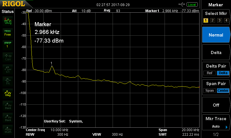

After more consideration, my tests in post #481 do not indicate any spin decay at ~6Mhz as I'd previously thought.  With the earth's field bias of ~1e-4T, the FID frequency would be magnitudes lower and I see no evidence of that so, the ~6Mhz frequency is most likely the self resonance of L1.
Posts: 2220
After more testing of the assembly in post #481 using a Rigol spectrum analyzer with higher resolution at the lower frequencies, the attached trace plot does show a small peak at 2.966kHz after averaging.  This was created with the generator source running continuous at an arbitrary 7.6MHz and sampling the current in L1.  This is more in line with what could be expected with the gyromagnetic ratio for copper at the low bias flux level of the earth's magnetic field IMO.  If this is true and the TPU does operate via an NMR means, then hows does one utilize this relatively low energy level to create the high output?
I plan to do testing with high frequency pulses applied with a repetition rate at or near ~3kHz and monitor the effects.
